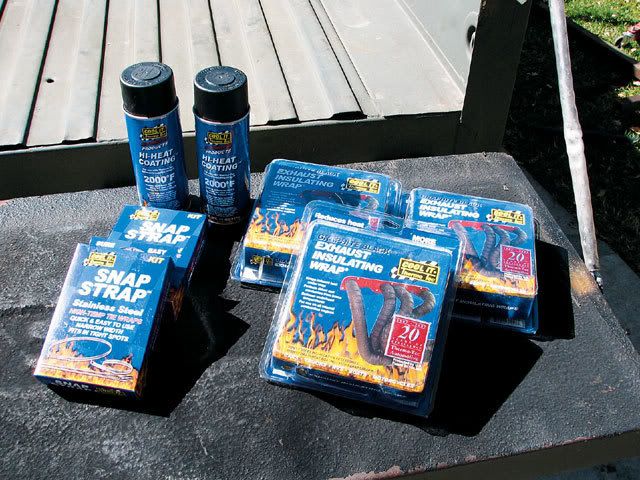

Ragazzi ecco le foto delle agoniate bende thermotech dell'americana COOL-IT

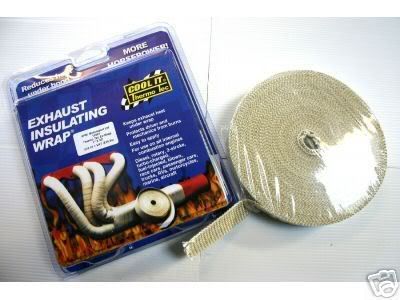

L'immagine qui sotto si riferisce alle bande termiche di seconda generazione molto piu' robuste e con ulteriore livello di isolamento dal calore
Thermo Tec Exhaust Insulating Wrap
1" x 50' (15.24 metres)
(this is the genuine ...COOL IT... Thermo Tec product... Not an inferior imitation..!)
Latest Type .... GENERATION II COPPER HEADER WRAP .... New Product
Generation II Copper Header Wrap improves heat resistance up to 30% more than current technology, by utilizing a new proprietary coating developed by Thermo-Tec; improved Thermal-Conduction-Technology (T-C-T). Generation II Copper Exhaust Wrap creates more horsepower and reduces under-hood temperatures, increases exhaust scavenging, withstands continuous heat up to 2000ºF, contains no asbestos. Generation II Copper Exhaust Wrap is sold in one or two inch wide, 50 foot rolls with a low profile 1/16" thickness.
A must have product for turbocharged, performance and race cars... Improves the performance of tubular and stainless steel manifolds and down pipes.
Reduces under bonnet temperatures by up to 70%
Increases exhaust efficiency for extra BHP
Withstands continuous heat of up to 2000 deg F
Protects sensitive underbonnet components and electronics
Keeps the heat in the pipe where it should be...
