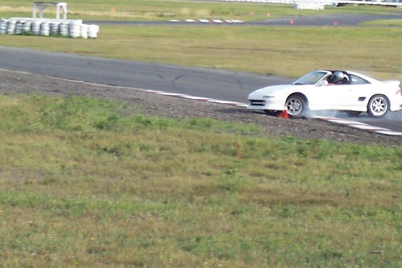

The front straight is a 1/4-mile long and on my second lap I had Hyde up over 120 mph as I approached the braking zone ... got on the brakes and total fade. :( The car was slowing, but not stopping and there was no way I was going to make turn #1.
My first thought was to go pass the turn as the road still goes straight for a couple of feet and then shoot the car on an angle across the grass. That idea was thrown out as soon as I saw the 2' square, 4"-tall concrete square sitting the grass ... so I had to hold it straight a little longer heading straight for a solid wall with a tire wall in front of it.
I was not fond of the idea of hitting that head on, so I nailed the car to the left as I went by the concrete slap and sent Hyde spinning. Luckily I spun right up along the tire wall and stopped next to it without having any contact.
This is as close to a tire wall as I ever want to be (turn #1 can;t be seen in the photo ... it is way to the right):

The only damage was a destroyed rear tire :(
We have since upgrasded to the Porterfield R4E (endurance) pads and ATE Supe Blue brake fluid.
The difference is astounding. I raced a hillclimb this past weekend (got home late last night) and the brakes were amazing.
I'll have to get it back to a track to see how they hold up on a circuit again.
